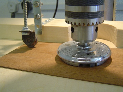

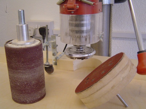

I use the Wagner SafeT planer for most of my thicknessing jobs, tops, backs &sides, necks fingerboards. If it's wood and needs thicknessing out comes the Wagner. I then finish off with a drill press sanding disc to final thickness. But, if you keep the Wagner sharp (very easy) and the table level then superb results are possible. In fact I have recently sold my 16-32 as it never got used. If you buy from SM they enclose a leaflet (also available from their site) that shows how to make the extra table that you will need and the hold down together with the bent coat hanger to check that the table is level. I can take any wood down to < 1mm with no problem.
This is my setup:
These are my Wagner's little friends, the drill press sanding disc and the large spindle sander, together they make up the most used set of luthery tools in my shop.
The drill press family tools are only limited by your imagination.

[QUOTE=Colin S] I use the Wagner SafeT planer for most of my thicknessing jobs, tops, backs &sides, necks fingerboards. If it's wood and needs thicknessing out comes the Wagner. I then finish off with a drill press sanding disc to final thickness. But, if you keep the Wagner sharp (very easy) and the table level then superb results are possible. In fact I have recently sold my 16-32 as it never got used. If you buy from SM they enclose a leaflet (also available from their site) that shows how to make the extra table that you will need and the hold down together with the bent coat hanger to check that the table is level. I can take any wood down to < 1mm with no problem.
This is my setup:
